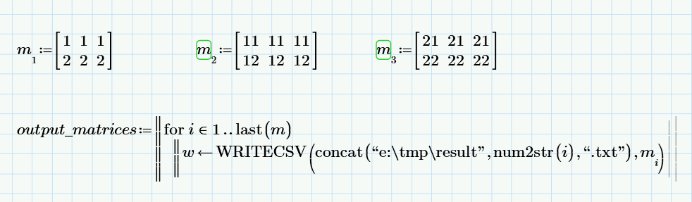

Hi all,
I have a MathCAD Prime worksheet to calculate a 2-d matrix called HL which itself is indexed with j. I need to calculate this matrix for j:=2..207 and I want each of these matrices to be saved to a comma separated .text file with a different name. I have figured out how, for a given value of j, I can save the file that I want, but I could not figure out how to do all this in a loop. I need a loop, or another way of doing this, so that I can save all those 206 files automatically. Many thanks for your help!
Roman

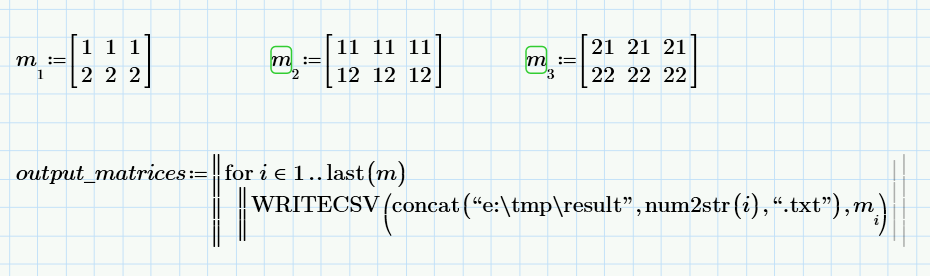

Best answer by Werner_E
See if this does the job

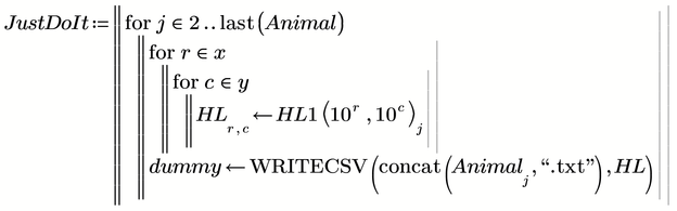

Dear Martin,
thanks for your interest to help. I have attached my MathCAD file in my reply to Luc. Does this allow you to offer a solution that would work for me? Many thanks!
Roman

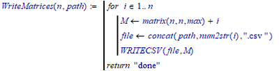

This little program
Creates n files: The line
M<-matrix...
Creates an n by n matrix with sequential numbers in the rows and columns starting at i
The line
fil <- concat....
Creates a filename containing the number i
And the line
WRITECSV...
Writes out the matrix to the file
Called with:
ït creates 3 matrices, the first contains:
1,2,3
2,2,3
3,3,3
The second contains:
2,3,4
3,3,4
4,4,4
And the third contains:
3,4,5
4,4,5
5,5,5

Dear Luc,
thanks for sharing your little program! This is helpful, I learned something already, but I failed to adapt it to my script and make it work. I attach my MathCAD worksheet here. Unfortunately I'm not able to share with the data, but you can see how I calculate the matrix, followed by a manual workaround for printing to file. How would I adapt my script to print each of the i:2..207 matrices to file?
Roman
Werner_E25-Diamond IAnswer
June 3, 2024
