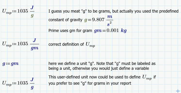

This file is in MathCAD 9, but I'm experiencing the same issue in MathCAD 10. I believe MathCAD is misrepresenting the units. See attached. "Hmp" and "TH" have the wrong values when comparing with example 11.2 at the bottom. I rewrote them as H and T next to them. I substituted "m" and "Ump" for the actual values of 100000 and 1035 and the answers came out correct. So, something is wrong with how "m" and "Ump" are represented.

Here you made an error when defining Ump. You used "g" for grams, but actually "g" is the predefined constant of gravity. You can tell that its a constant and not a unit by the color - its green and not blue. In Prime you have to use "gm" for unit gram.
Feel free to define a unit "g:=gm" somewhere at the top of the sheet if you want use "g" for gram. Actually "g" is the only unit symbol for gram that is recognised by the SI (International System of Units). "gm" is not allowed by SI standards to avoid confusion with gram-metre g*m.

Werner_E25-Diamond IAnswer

Werner_E,
Thank you so much for your thorough explanation!!! I applied the correct units you suggested and everything works the way it should!
