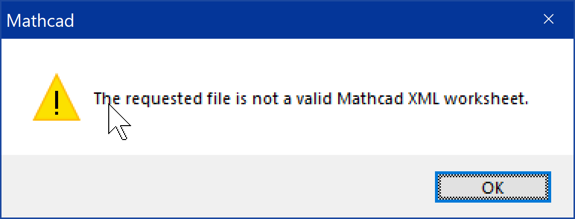

I have several files I created last year.  They are typed as xml files.  Now when I try to open them I get a message that they are not valid xml files.   Can someone explain why this happens and how to fix it.  I am attaching one of the offending files.

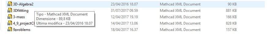

I've no difficulty opening my worksheets. The type indicated is XML as well.

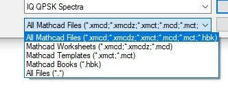

 make sure you open the files correctly

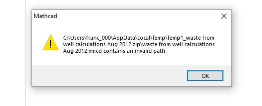

I put the file in a compressed folder and attached it.  Can you open it ?
-MFra-
(To:Joeboy)
I downloaded the file, but mathcad gives me your same error.
I am perplexed. What to tell you? wait for the response of some other member of the community.

This is not the message I got.  Mine simply said "invalid XML file"

I am surprised, too, by the message Francesco got. I get the same as you:

Why I get that error message from Mathcad? Because the file you sent is damaged. The content got deleted and replaced by all bytes being FFhex.

Bad news!
When I look at the file you posted I see that all the bytes in that file have the same value hex FF.
There is no information which could be retrieved.
