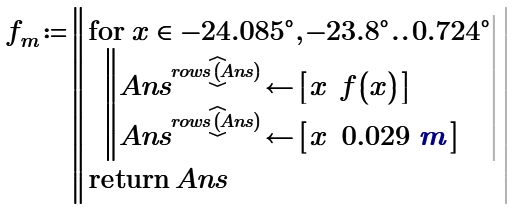

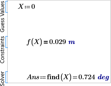

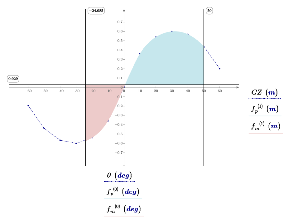

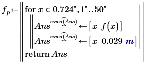

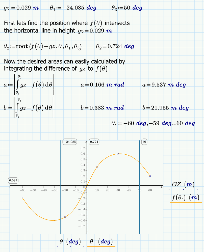

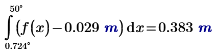

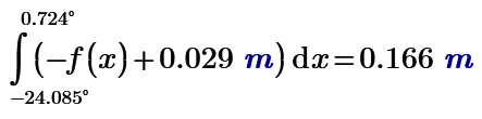

I've shaded a portion between markers and curve as one portion as a other as b, how can i find area between them.
4 REPLIES 4
(To:MM_10735997)
Maybe that way
Keep in mind that the "area" is of dimension length times angle. Probably you are interested in the value with meter times degree.

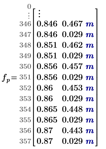

Prime 9 worksheet attached
can i know the function of the shaded portion
