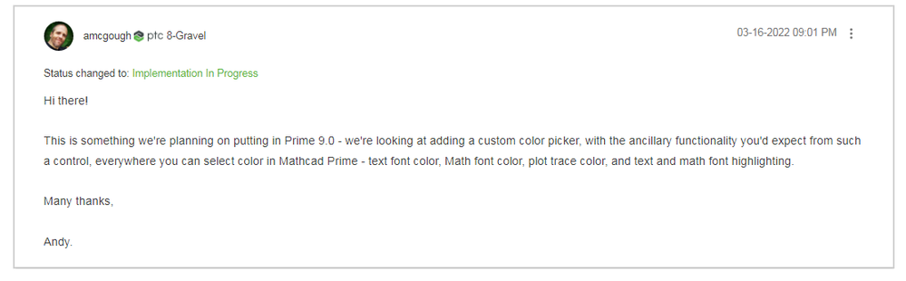

The custom colour picker Andy described did actually happen in Prime 9; it just doesn't apply to the page's background colour (nor did he say it would).
Region border that Mona described in 2011 will happen in Mathcad Prime 11, though from what I just heard, it's similar to "show frame" as currently implemented in that you only get one border variation with no colour customisability.
There's still no word on changing Prime's page background colour.

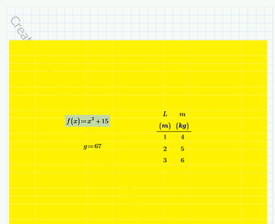

LucMeekes
(To:ppal)
Nope, maybe it is planned for Prime 9 3/4.
There is a work-around though.
You can make a text block, the size of your page, fill it with tabs and set the background colour for that block. Now you can move your equations onto that text block and they can even have their own background colour.
It also helps to suppress the ugly page-spanning 'watermark' in Prime express.
But it makes adding and editing equations a bit of a challenge...
Better wait for Prime 9 3/4.
