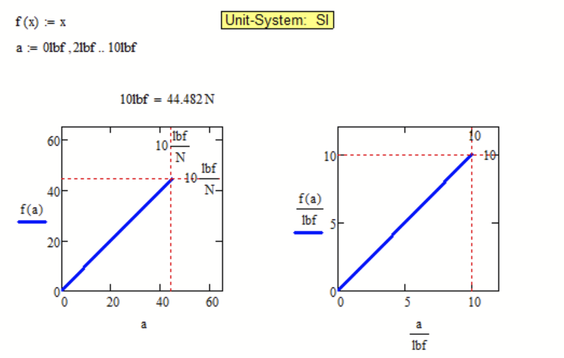

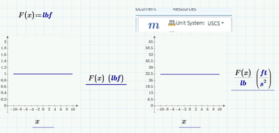

The following pictures show the problem/bug.

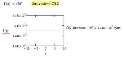

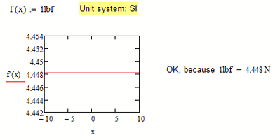

If the unit system is SI or MKS, plotting forces shows the values in Newton, which is as expected.
(Unit CGS shows them in dyne which is also as it should be).

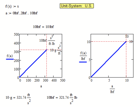

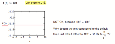

But if the unit system is U.S., the plot values do not correspond to pound force as expected, but for some reason rather to lb*ft*s^-2, which explains why dividing by g as written by @prop_design  gives the desired value (in lb, which then is also shown in the plot).
Dividing by the unit we'd like to see (as we are used to do) of course works OK regardless of the unit system chosen.
BTW, unit integration is a bit improved in Prime and the plots do not show this strange effect. Choosing unit system USCS correctly shows lbf. Nonetheless I couldn't be bothered downgrading from Mathcad to Prime.

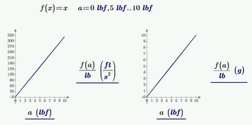

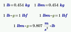

I don't see the issue (maybe dense in my old age,  😉 .)  By definition a pound force equals the weight of one pound mass in earth's gravity.  (Yes, I know that's not the official definition, but it's the one most of us still struggling with English units can remember.)  Mathcad (Prime in my example but classic too, I'm sure) shows this:  Capture.JPG
For those of us who may have forgotten, the English unit of mass is a "slug."
Prime also produces the plots like classic:
No issue, no bug, just standard confusion!
The issue is, that the plot values (without dividing the axis values by a unit) correspond to Newton when we select the SI system and thats what we expect, as in SI the standard unit for force is Newton. You can see that the plot (the left one), which is defined for values up to 10 lbf, is running up to 44.48 which corresponds to 10 lbf = 44.48 N.
When choosing CGS the plot runs up to 4.448*10^6 which is as expected, because 10 lbf=4.448*10^6 dyne and dyne is the default unit of force in CGS.
But if we choose U.S. the default unit of force is lbf and so we would expect the plot running up to 10, corresponding to the upper limit of 10 lbf.
But rather the plot runs up to 321.7!
The workaround which prop_design mentioned is to divide the quantities by g. This results that we don't see force anymore but rather mass in lb and because lbf=lb*g the numerical values are the same as with lbf. Now Mathcad would show the plot up to 10 because in U.S. it uses lb as standard for mass.
But this workaround should not be necessary - we would expect Mathcad to show the plot up to 10 also when plotting quantities of force in lbf.
As Mathcads unit system states that the default unit of force is lbf, we would expect any force displayed in lbf unless explicitly otherwise demanded and this would also apply to plots.
Of course its always the best idea to divide by the units you'd like to see as done in the plots on the right side of my pictures. You are on the safe side doing so, so are nor forced to the standard units and you also see by the axis expressions the units without having to add an axis label.
