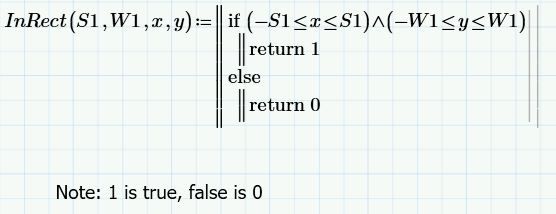

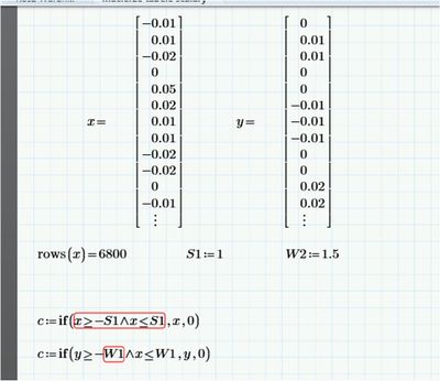

I have a date in two columns, but i have to do filtering or conditions to select only date (x and y) which are inside rectangle.

How i can get date in two matirix (E.g xx and yy matrix)
In appendix is date and math date
It loks ok
Best I can do is send a pdf of the worksheet.  There is not much to retype.
Prime has no mechanism to back save to previous additions.
Cheers
Terry
ok thanks it's working
