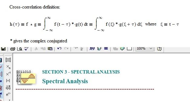

You can find something about the correlation of signals in Mathcad's E-Book "Signal Processing" 15.
Joop
(To:-MFra-)
Thanks again for your answer. Is this E-book public available?
For me this is not the answer I am looking for. I could guess that these are the equations that are solved. But maybe something different is done. I should be sure about the math that is solved and need a reference that states that exactly this equation is solved.
