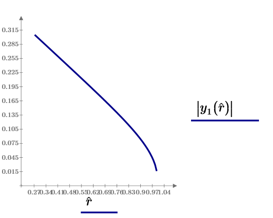

Hello Mathcad community
I would like to calculate the isotensoid contour of a pressure vessel and need help with the following calculations, because no graph is generated from the values.
Thanks for any help.
Seb
ttokoro
(To:Seb)
Can not plot imaginary results.
