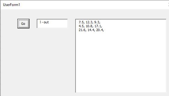

c) It Outputs from Prime the names of the first Inputs and Outputs the output matrix.
d) It shows the Output matrix from Prime into a VBA text box.

The VBA Form has a Go button.  Press the Go button and the excel subroutine associated with the click of the button does a few things
a) It Runs Prime and opens the worksheet.  The location is simply coded in VBA so Path and Filename will need to be adjusted for where you save the two files.
b) It Inputs into Prime a value with units and a matrix.   The values are coded in VBA.
    The example does not show how values can be extracted from Excel to VBA as this is covered by VBA Help.
    The example does not cover how values in VBA are sent to Excel as this is covered in VBA Help.
