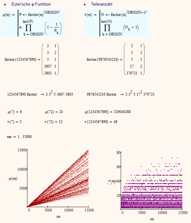

Just for demonstration I add a sheet which I posted here quite some time ago when someone has a question to prime twins and prime cousins, etc.
I now added a function to factorize numbers and then it was easy to also write the Euler phi function or a function for the number of divisors.
But be aware that things really get slow when it comes to numbers with very large prime factors!
And in no way I claim that my implementations are optimized for running speed and memory usage. They are certainly not, and there is still a lot of room for improvement.
EDIT: Added Function to return the set of all divisors (quite inefficient) and a divisor function (returns sum of powers of divisors).
EDIT2: Added a far more efficient "Teiler" function to return a vector with all divisors.
TODO: make the old  prime number functions accessible for symbolic evaluation
             speed up prime number functions (nextPrime, etc.)

Many Thanks. The small programs help a lot. I no longer have to count my fingers sore, although my generation still learned arithmetic with pen and paper and many wastepaper baskets were filled in the process. I have to admit that programming is not my forte. I feel more at home near Hausdorff's theorem. But at the moment I have the opportunity to deal with arithmetic problems from number theory. I can enjoy that now, while trying to get a gut feel for the thinking of great mathematicians of the past.
