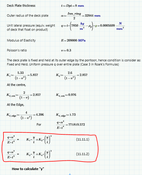

how to calculate "y" in the below mentioned equation

Other than that, the answer is found by:
Most probably it is:
or, in Prime Express, and numerically:
