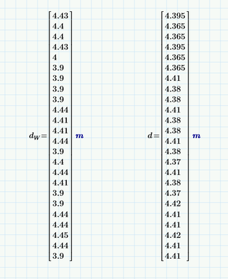

Hi all, I've created a vector value as shown below
does anyone know how to create an 'if statement' to get the min/max results for these two vectors?
Your help is kindly appreciated
You don't need an if statement:
5 REPLIES 5
this works for me. Thank you Alan!

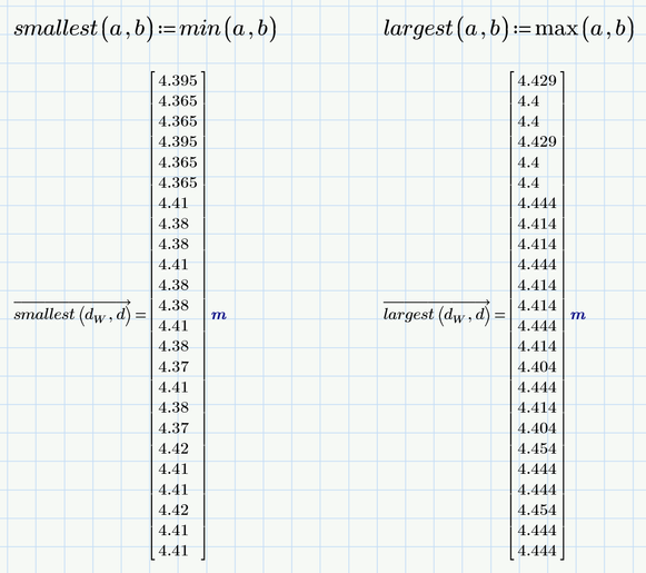

I'm sorry, I couldn't help it.  I just had to generalize the problem.  What if I had more than two vectors, I thought, or even multiple arrays of differing lengths and column sizes?  Fortunately, this is an exercise in cat-skinning.  Here's one method that pays homage to my dislike of explicit iteration.  It's not totally functional because I thought such an approach would make the technique more obscure.
And now the rubber of the functions meets the tarmac of the data ...
Seems to work, as did a few nst2mat test cases using arrays of differing row and column sizes (see worksheet).
