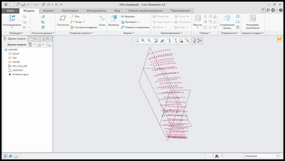

I took the worksheet a step further.
We can take the 2D profiles of the blade calculated (I modified Alan's worksheets on Axial flow machines)
Generate the XYZ coordinates and use the curves at specified intervals along the blade to recreate the solid part in CAD. (Creo parametric in this case)
In this example the centre-tip and centre-hub radii are varibles in Mathcad. (they can be associated with parameters in CREO)

in the worksheet XFL and XFU are 2 arrays that are used to create the Lower and Upper surfaces.
The data needed to be reordered and trimmed down (if I remember right, there were duplicate points when the surfaces were combined.) and then stitched together to make one array (just because thats the way I wanted to export the data) The program below does that.reorder-points-3d+array.jpg
Now your XYZ data that you can either export in a file format of your choice using the variuos WRITE functions available
or
As I have done below use the Analysis feature based integration to connect Mathcad arrays to Creo.
The arrays, CS0, CS1 ...etc are created first
and then evaluated and assigned as inputs to Creo (from the Input/Output tab)
For other ways of data export from mathcad to CAD.
Have a read of this blog..http://blogs.ptc.com/2013/05/02/points-lines-and-triangles-oh-my/

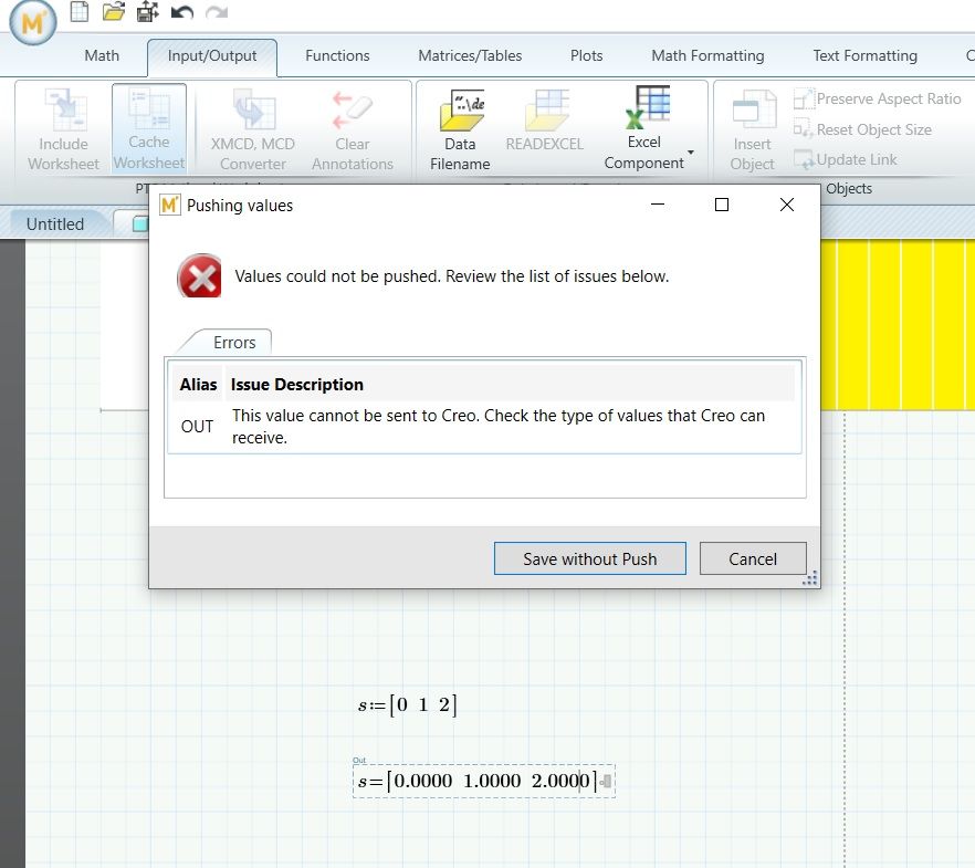

Hello!
I receive an error message each time that I assignt the output values. Can you upload a similar worksheet? I don't understand how to assign the output values or what I am doing wrong.2.jpg
