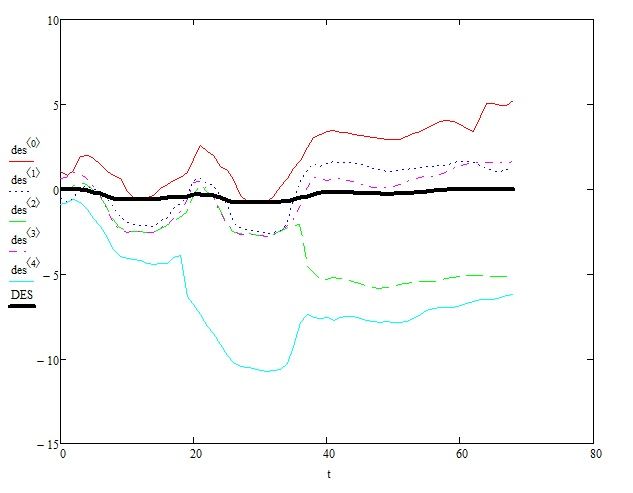

how to synchronize all array ?(attached mathcad file)
Mathcad111
is there any inbuilt function to synchronize all the array so that i will get something like (given picture"file name: output.png")?
(To:Mathcad111)
Comparing the two curves with index 9 (red) and 10 (green): How would an "equalization program" decide that the red increasing at 100 is wrong and should be decreasing like the green curve?

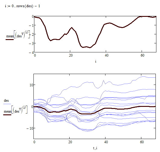

Synchronizing seems excessive to me, but it is possible to average:

-MFra-
(To:Mathcad111)
I did this analysis to see if something particular came out. But there is not. So it does not seem useful. However I attach the file.

You will have to explain what exactly you mean by "synchronize" and how the plot you show in your picture should be derived from the data you provide.
If averaging as shown by FM is what you are after, it can be done that way, too:
i have uploaded new files check once.

Essentially what the Equalize routine does is take away the (assumed !!) slope of every trace.
From the result it can be seen that that assumption may be wrong.
