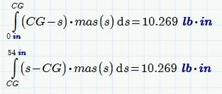

integrating to find the balance point.

I don't understand why the first moment of integration doesn't balance the beam.

Sorry, I do not see any problem - see the attach
The first number (17.056 in) is the balance point, if you pick it up there it won't tip. I was mistakenly assuming that was where half the mass was on one side and half on the other; that will only be true for a symmetrical arrangement.

Yes, but I was puzzled, too, when I first glanced over your sheet.
You get equality if you take in account the distance from the centroidal axis:
Yes, the weight moments balance, but the weight does not. That's where I was getting confused.
Trying to do vibration of a non-uniform beam, solve for natural frequencies. Rayleigh method needs a shape function, I thought, "balance the beam at it's CG." and got lost on where the CG was when the weight on one side was more than on the other.
