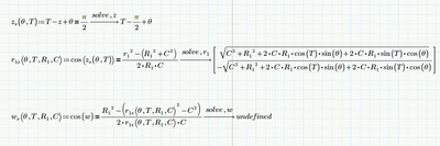

I'm having difficulty solving for a variable in Mathcad prime 3.1
Could you please let me know?

Please see my attachment

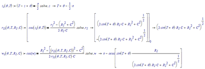

I find this:
There are two solutions for t.3s.
You find none, maybe because in your solve block the labels of t.3 are different.
The guess value t.3 is labelled 'variable', while the t.3 in the constraint is labelled '-' (automatic).
Make them have the same label and see what happens.
For your R.2s solving, a similar thing happens. The labels for R2 are the same, but those of r1 aren't. Correct that and see what happens.

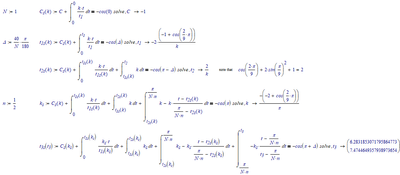

My issue is down here
This one and downwards.

You (may) have to choose one of the two solutions for r.1s.
I chose the first one, to get:
