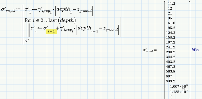

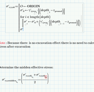

I'm trying to find the effective stress, I wrote a program in mathcad however the result was zero always
I think the error occurs because of the depth . Since I need to use the previous depth of each stress and not the depth in the same point.
Can anyone please help me?

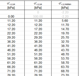

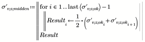

Also I need to find the midden value but not sure how to find that
in excel
in mathcad
(To:YA_10963798)
A for-loop needs at least a start and a stop value (like a range).
Are you looking for this
or should it rather be this
And then
No need for defining any range variables like i.n or j.n
Prime10 sheet attached

You probably want:
rather than
(I can't test it as I only have an Express version).

(To:YA_10963798)
And then
