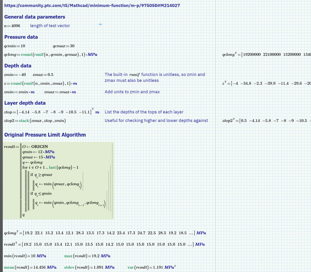

I wrote a program to correct the value of q. I wanted to choose always the minimum value and I put the maximum limit to be 15 MPa , I don't know why it is not working . Do you know how to solve this problem?

First, let's look at your limiting program and see where it's going wrong.
If you look at the second value (index O+1), you want the minimum of qmin and the values at O and O+2, which are 12 MPa, 11.4 MPa and 15.8 MPa, respectively.  The minimum of these is 11.4 MPa, which is what we see in result.
Rather than max(qmin,qclongi-1,qclongi+1) what you want is max(qmin,min(qmax,qclongi-1,qclongi+1)).  IOW, you get the minimum of qmax and a values two neighbours and then the maximum of that and qmin.  The min returns a value with a maximum value of qmax.  The outer max returns the min value or qmin.
And then there are the end values.  I've used q to limit them because q has the same values as qclong, and it's less typing and horizontal space (thus making it slightly more legible).

If all you want to do is restrict the vector values to given limits, then I'd recommend that you use a general purpose function that is tailored for that purpose.  Try the function limit shown below.

To limit a value v between a min (a) and a max (b) value you may use
limit(v,a,b) := max(  min(v, b), a)
Use vectorization to apply to a vector argument.

It wasn't clear to me, either.  A simpler version of the program would do the trick, and use else if and else to handle the different cases, rather than evaluate q[i twice.  And it handles the two edge cases.
