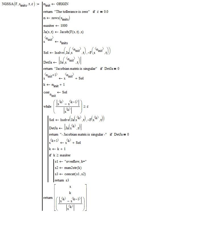

Hello.

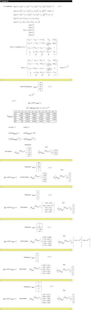

I've been trying solve 5x5 matrix for some time method of newton but something is not correct. Anybody can help?
16 REPLIES 16
(To:ptc-3682623)
The vector x in your program has only three elements but the function newton/F requires a 5-element vector.
If I correct this by setting x as 5-element vector with all 1's I get a singularity errror because the matrix created by F ist not invertible.
You may have to check the algorithms used.

(To:ptc-3682623)
Your program uses a function f.x which never is defined.
ptc-3682623
(To:Werner_E)
Now is ok. I've done but allways I have 0. Why?
(To:ptc-3682623)
Because Pic.png  for any vector x and any value t. So newton always returns a vector with all zeros.
You should always test your functions with dummy data to see if they do what they are intended to.

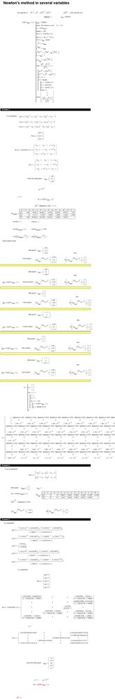

Hi!
Hereafter, there are some examples that use the Newton algorithm. Lastly, there is also one related to your problem. But it is the only one that is not soluble in the presence of a singularity.
Greetings
FM
-MFra-
(To:-MFra-)
... in fact my results are very strange ... just look at the two examples attached.
-MFra-

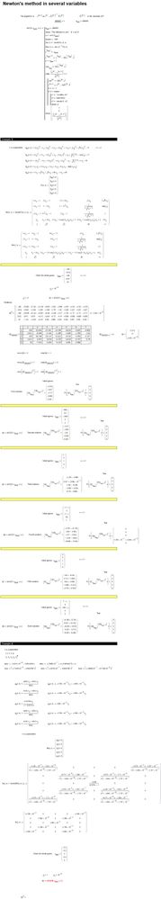

(To:ptc-3682623)
You can get the same results without calculating the Jacobian inverse matrix. See the following program:

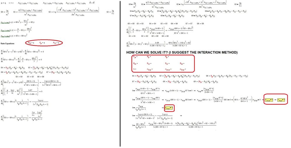

ptc-3682623
(To:-MFra-)

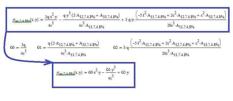

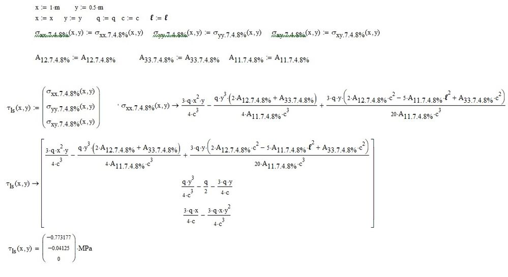

Thanks:) Please look at attachment. You will find what I want to do with my calculation. On page 27th.
-MFra-
(To:ptc-3682623)
To simplify the calculations and to reduce the calculation time, it is convenient, both for me for an easy understanding, but also for you, for example, to simplify and reduce expressions and equations in this way:

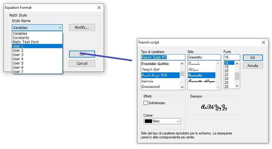

furthermore, since the letter l is easily confused with the number one, it is advisable to change the font only for that character by assigning it to user1 through the format equation panel shown here:
