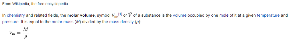

There is another formula for molar volume:

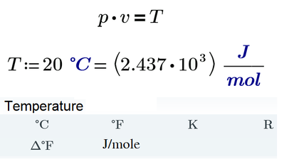

Here R is the universal gas constant, so your equation needs a universal constant
Fred_Kohlhepp_3-1634906836952.png  To use your expression would require a new definition of temperature scale
