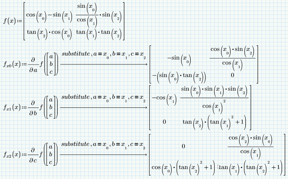

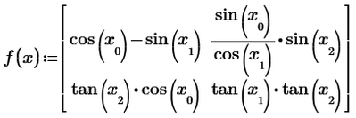

I can define this function and it works. What I cannot do is the partial derivative with respect to some of the independent variables, written as a component of a vector. Any suggestions?.
I want to do the derivative with respect to
and he writes me this
(To:LucMeekes)
Unfortunately the Nabla operator is of no help here. It can only be used for scalar valued functions like
but it fails here as the function given by @hegel  returns a 2x2 matrix:
It is a great pity and a major shortcoming that Prime is generally not very good at dealing with vector functions and thus the partial derivative according to a vector component is not possible.
A clumsy workaround could be this (assuming that the input function f() is for good reason defined as a vector function and not as a function with three separate arguments and also assuming that the partial derivatives should be assigned to vector functions as well):
Prime 9 worksheet attached

Prime can do it BUT it's not pretty, and it's not elegant.
The derivative function won't let me use an index subscript.  If you define a function of three variables you can beat it to death!

Have you checked the gradient operator?
(To:LucMeekes)

wonderful, thank you a lot
