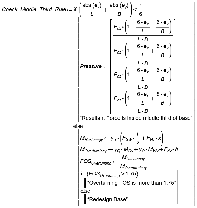

Hi guys,
I'm trying to do a simple calculation of the middle third rule. What I want to achieve is shown in the spreadsheet but the issue is that if the condition ex/L+ey/B<1/6 is met only then I want the program to calculate the pressure otherwise just get a message like "N/A". Can the result be either a scalar or a text? I tried to put be a scalar with "N/A" for each of its elements but got an error message again, it seems that it accepts only numerical values

I put it in a program and find the solution. Thanks anyway.

Strange how this works. So if I use the equal sign to the variable definition, I got an error saying that the variable should be a scalar or a matrix but if I don't and just write in a different row the variable, I go the correct message! But then, I don't get the Pressure although I have define it inside the program.
Any idea why this happens?
