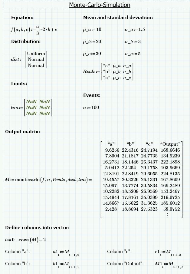

s-soberh
9-Granite
(To:DJF)
Based on your message, I tried it with the Monte Carlo. Unfortunately, I do not know how to continue. Maybe someone has the time and the desire to look at it. It would be great if you could write down the necessary lines. Best with a graph, which parameter has the most influence.
DJF
(To:s-soberh)
Easy enough, you just have to replace the relevant input data in my sheet.  Unless you want something different.
s-soberh
9-Granite
(To:DJF)
Many Thanks DJF for your quick support.
I would have made a small change, but the values in the graphs do not match the means and standard deviations. I've added two more parameters, but it looks like it's not working anymore, although in my opinion I've changed everything.
Do I have to change anything in the program?

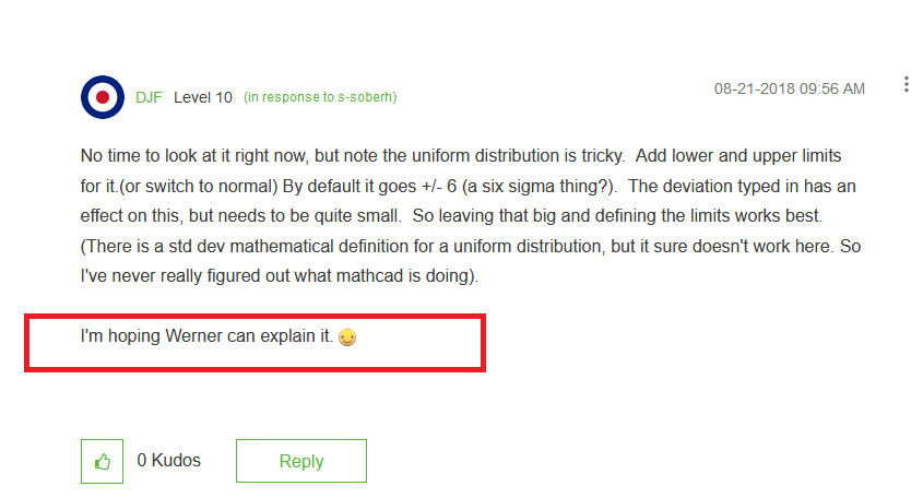

DJF
(To:s-soberh)
No time to look at it right now, but note the uniform distribution is tricky.  Add lower and upper limits for it.(or switch to normal) By default it goes +/- 6 (a six sigma thing?).  The deviation typed in has an effect on this, but needs to be quite small.  So leaving that big and defining the limits works best.  (There is a std dev mathematical definition for a uniform distribution, but it sure doesn't work here. So I've never really figured out what mathcad is doing).
I'm hoping Werner can explain it. 🙂

DJF
(To:Werner_E)
The question is about how Mathcad uses the uniform distribution within the montecarlo built-in function.  The input is the distribution (Uniform) and a standard deviation (and optional limits).  (maybe std dev is the wrong term here, but it goes in the same column as the other std devs)  The distribution responds to the deviation input typed (i.e. upper and lower limits move), but I'm stumped as to what the mathematical relationship actually is.  So I just set the optional hard limits and I seem to get a distribution that looks appropriate - but without understanding the math maybe I'm doing something wrong.  Seems like the kind of thing you're normally knowledgeable about.  For examples just see my files in this thread - 3rd row in the inputs.  Thanks.

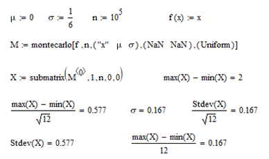

(To:Werner_E)
OK, I played around with montecarlo and the uniform distribution and here is what a found:
If a and b are lower and upper limit of the uniform distribution, the standard deviation is sigma=(b-a)/sqrt(12).
Someone at PTC might have made an mistake as the value of sigma in montecarlo is interpreted simply as (b-a)/12.
So, if you want a uniform distribution with limits [3;5] you would provide mean value mu=4 and (the wrong) standard deviation sigma=1/6 (the true standard deviation of this distribution is 1/sqrt 3 ).
This strange effect is also present in Mathcad 15 (which is the version where DOE and montecarlo were introduced the first time if I remember correct).

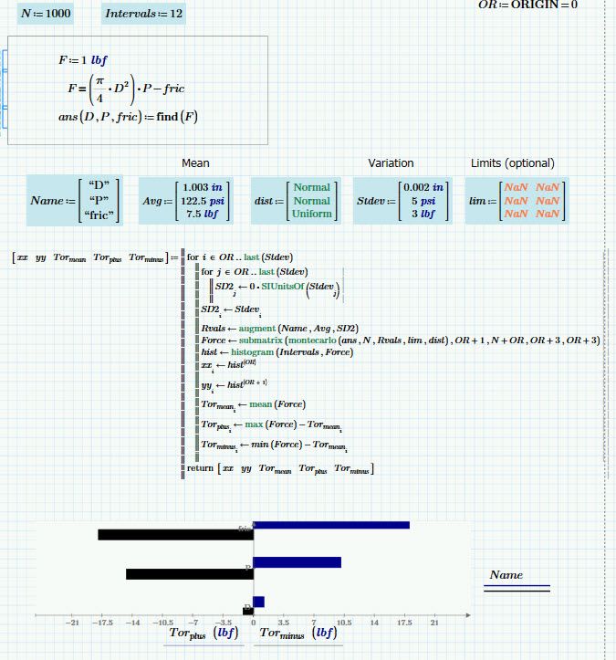

DJF
(To:s-soberh)
I came up with this to make a tornado graph (and histograms) from a monte carlo.  The monte carlo is run several times, wherein only one variable is allowed any deviation at a time.  Not the prettiest graph, but gets the job done.  (Simple calculation looking at force output of a piston where the variables are diameter, pressure and friction)
4.0 attached
