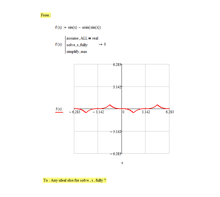

sin( x ) - asin( sin( x ) ) , solve , x , fully ?
lvl107
20-Turquoise
Hello Everyone.
From :
To : Any ideal else for solve , x , fully ?
Thanks in advance for your time and help.
Best Regards.
Loi.

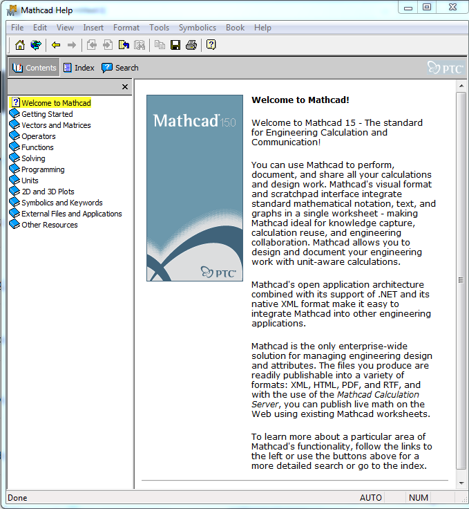

lvl107
20-Turquoise
(To:ttokoro)
  Ttokoro, I have just looked at help page and :
   What contents or index ?

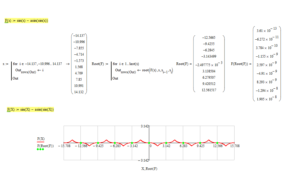

lvl107
20-Turquoise
(To:ttokoro)
 Many thanks, Ttokoro, I follow your instruction then :
Best Regards.
