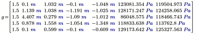

Saludos comunidad, tengo un problema con la solución a través de un bloque solucionado para determinar los diferentes valores detallados.DC_11916766_0-1758248874077.png(PTC Mathcad Prime 10.0.0.0)
  • El problema que tengo es que el resultado para cada fila de la matriz g es el mismo, y no debería ser así, específicamente

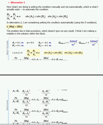

(i) ¡Cuatro ecuaciones y una restricción para encontrar siete variables no funcionan!
(ii) ¿Mx, My, Ps deben estar en las ecuaciones del bloque de resolución para usarse como entrada en el bloque de resolución paramatizado?
(iii) ¿Las funciones Q1, QQ1, Q2 y QQ2 calculan vectores y devuelven el último elemento calculado del vector, que se equipara a valores individuales?
Si desea generar el vector, indique valores de retorno específicos.

As you only have four equations but look for seven variables, you sure have to investigate further and find three more equations.

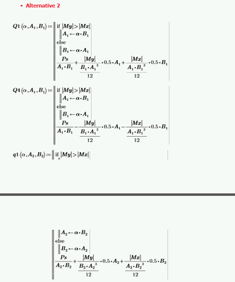

Your Q1 and Q2 function seem to be completely identical apart from using different names for the input and local variables. You have to understand that the formal argument names may, but must not be of the same name as the variables you later use for calling the function. And the local variable used to hold the result of your function bust not have the same name as the function!
Because you want you solve block be dependent on three values Mx, My and Ps, these values must be arguments of the functions used in the solve block.
Its not necessary to define qn.min and qnmax in the solve block. They already were defined a the top of the sheet.

I tried to streamline your four functions Q1, Q2, QQ1 and QQ2 and ended up with just two functions Qmin and Qmax. But I am absolutely not sure if I correctly understood what you were trying to achieve, so you will have to thoughtfully check them!!

BTW, I changed your guesses for alpha, Qmin and Qmax. You have a constraint for alpha that  it should be a value between 1 and 1.5, so why do you provide a guess of 0.5?
And the values for Qmax and Qmin you expect are in the magnitude of 10-12 tonnef/m^2, so I changed your guess of 1 to 10.
Using your original guesses Prime would not find a solution for some values of Mx,My,Ps.
But you sure will have to work on your solve block equations anyway, finding additional equations so to make the solutions unique.

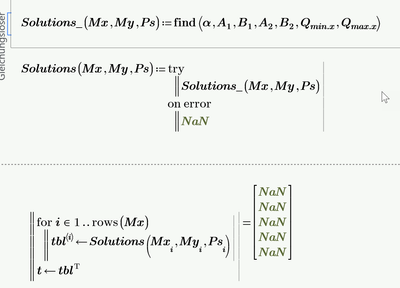

Main problem still remains that you have just four equations but solve for seven variables.
Primes solve block tries to find correct solutions and it looks like it succeeded in your first solve block
Concerning the second solve block I used try..onerror as shown before to see which set of input values make the solve block fail.
As you can see there seems to be no input triple for which a solution exists.
Reason seems to be that your various q, Q functions are NOT using the values Mx,My and Ps you feed into the "solutions" function but always the values for these variables which you have defined somewhere above the definition of these functions.
