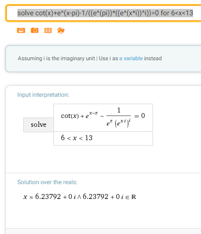

solve cot(x)+e^(x-pi)-1/((e^(pi))*((e^(x*i))^i))=0 for 6<x<13 ?
lvl107
20-Turquoise
From:
I.PNGsee : https://www.wolframalpha.com/input/?i=solve+cot(x)%2Be%5E(x-pi)-1%2F((e%5E(pi))*((e%5E(x*i))%5Ei))%3D0+for+6%3Cx%3C13
If someone could explain above the above, please help.

Guess you found out that uncle Wolfram isn't perfect, either.
You get different solutions depending on if you chose 6<x<10 or 6<x<13 and you get the same solution twice - too bad!
For another funny effect you may click on "More digits". All in a sudden Wolfram offers two more solutions and both are not within the constraints.
Looks like the world isn't perfect and math progs aren't, too 😞

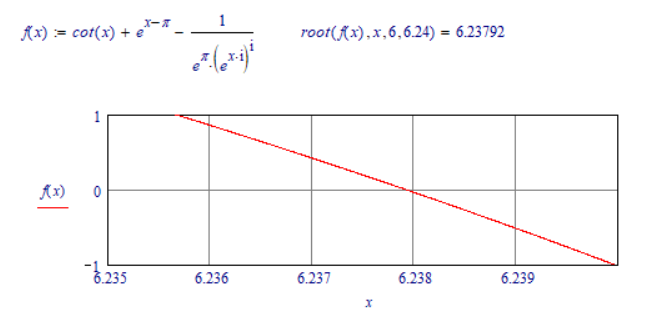

Luc, I guess there is a misunderstanding my question :

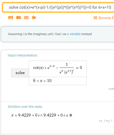

IIa.PNGI need a explanation about how to get the second solution, x = 6.237916547633475
see : https://www.wolframalpha.com/input/?i=solve+cot(x)%2Be%5E(x-pi)-1%2F((e%5E(pi))*((e%5E(x*i))%5Ei))%3D0+for+6%3Cx%3C10

I need help explanation about the Missing solution - How to get the second solution x = 6.237916547633475 from that formula, from that hint.

I have just done for solving one of other missing solution "by hand" with root function and guess value x = 12.566289908047107. ( that is the reason for explanation how to get other missing soution from that formula, from that hint.
Best Regards.

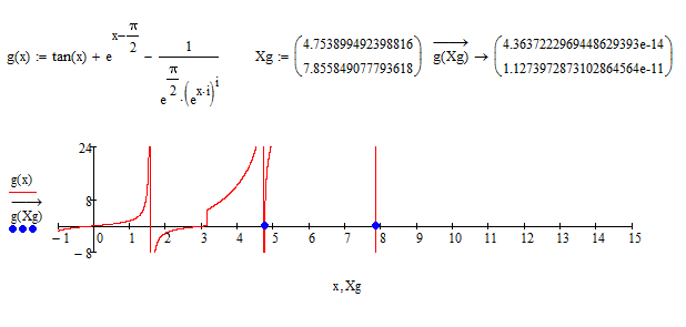

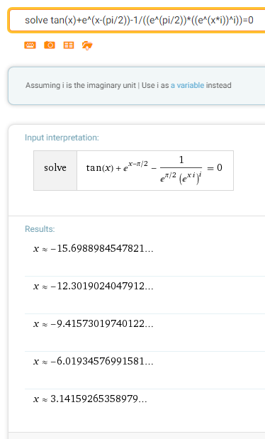

Yes. I guess so, Werner.Smiley HappySmiley HappySmiley Happy  and anyway I guess we would have to solve it "by hand" with root function and guess values. And another example :
https://www.wolframalpha.com/input/?i=solve+tan(x)%2Be%5E(x-(pi%2F2))-1%2F((e%5E(pi%2F2))*((e%5E(x*i))%5Ei))%3D0
b1.PNGb2.PNGRegards.
