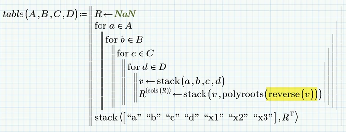

I would like to know if you could help me please with some idea how could I solve the following 3rd degree equation:
- equation is of type ax^3+bx^2+cx+d=0
- each of the coefficients has a max and min value:
    • a ->(amin, amax)
    • b -> (bmin, bmax)
    • c-> (cmin, cmax)
    • d-> (dmin, dmax)
It results a high number of 3rd equations to be solved from all the possible combinations of the min and max values of the coefficients.
Solving each combination in part takes lot of time, so I would like to know if there is any possible way to get the solutions from all the equations obtained from all the possible combinations of coefficients?
Thank you,
Marius

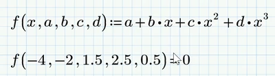

Yes, you are right.  I used the order used by polyroots which is coefficient of x^0 as first value.
Actually I hadn't noticed that thats differently from the function definition the IP used in his question.
If thats an issue it can easily be changed

Here's one way:
Alan
(the attached file is M15 format)

Marius_P10-MarbleAuthor
Jan 23, 2023 4:01 PM UTC
Hello Werner,
Thank you for your help. I followed your solution but it seems to not work for me. Could you tell me please why?
