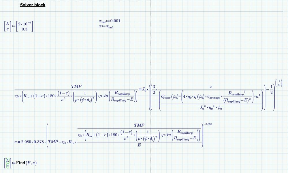

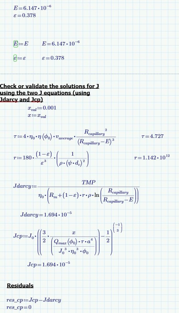

I do not have version 7 to hand at the moment so solved it in version 11 and will use screenshots.
Amend the solve block so it has only two variables E and ε.
Equate the two equations for J and substitute equations for Tau and r into the two equations that are left.
Then the correct J's can be calculated.

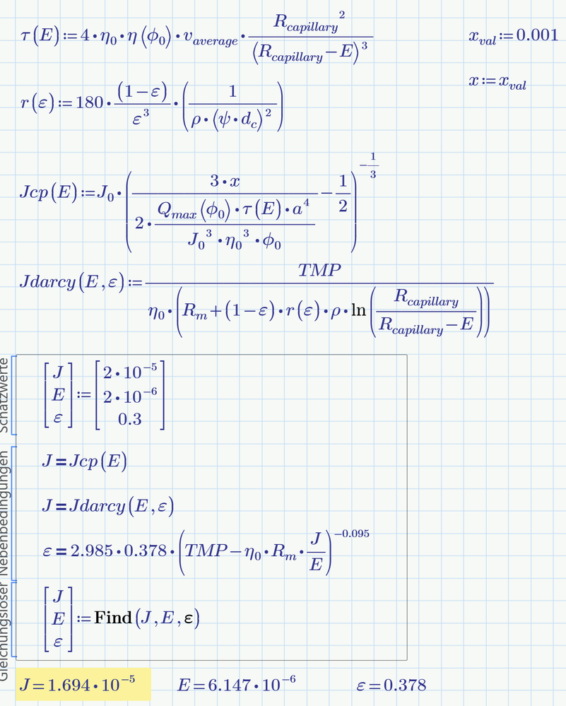

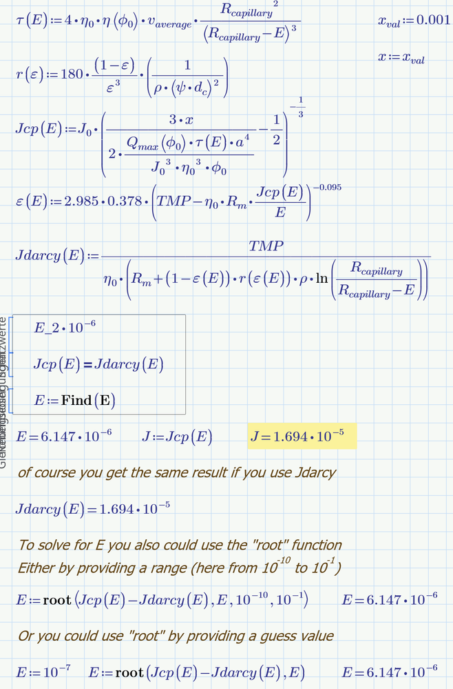

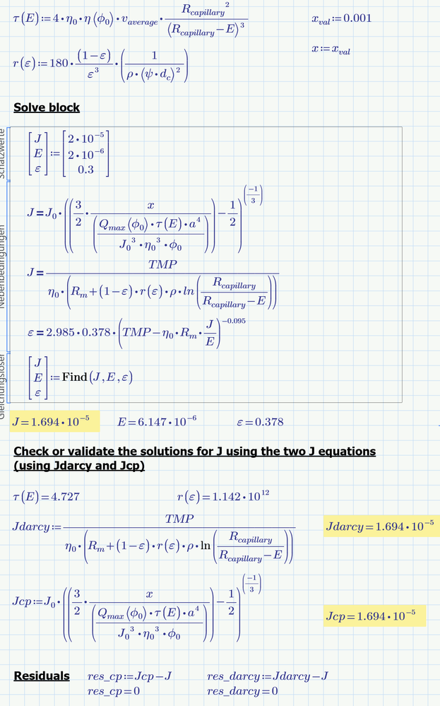

The reason you get wrong results is because of your definition of variables tau and r. These calculations just use the guess values you provided for E and epsilon and do never change!
I would suggest to turn tau and r into functions (in front of the solve block) and use them in your equations. As I don't have Prime 7 installed I can only provide screenshots, but I attach the Prime 11 file in case some kind soul is able and willing to convert it to P7 format.
You may also consider turning Jcp and Jdarcy into function and  use them in your solve block:
You may use functions until your task does depend on one variable only, I had chosen variable E. So you just have to search for the value of E and can use this value to calculate J (and if necessary also epsilon). For equations in just one variable you could also use the "root" command.
