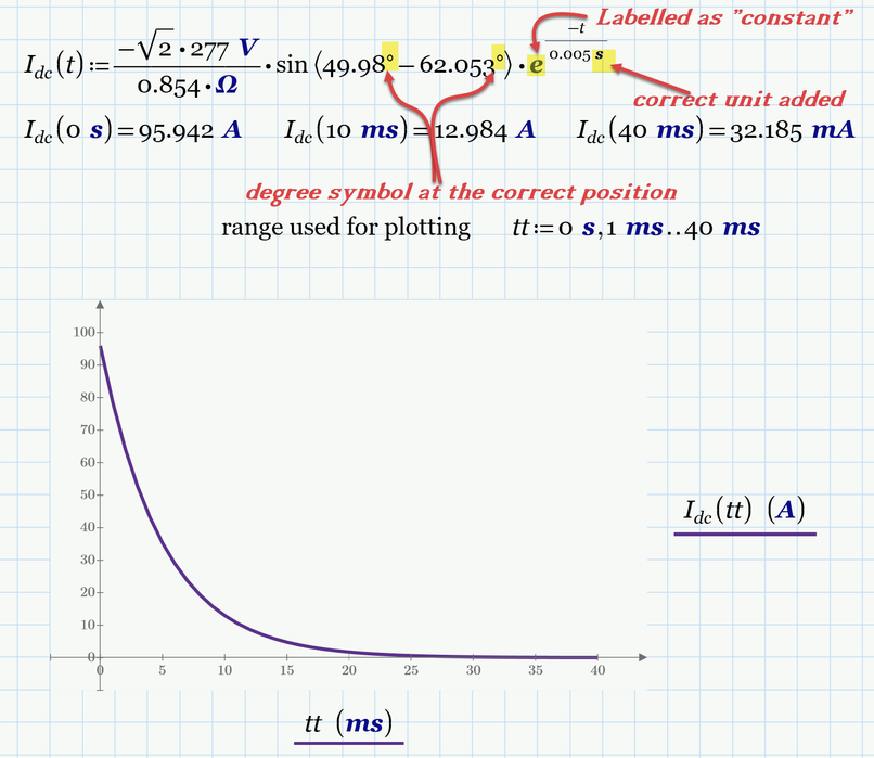

Can anyone tell me the correct syntax for using trigonometric functions?  When I try it, I get an error result that says "missing term or expression".  All help appreciated

So, for this same calculation, is there any way to get a clean answer as a function of t with the required format: (95*e^-t/0.005)?
I get the format, but with units in it, and wrong numbers,
How can I type solve,t,simplify together, as you did in your sample worksheet?
In the main calculation, I disabled the region where you said I redefined sin alpha
, so the final calculation becomes correct, but if I type a= I dont get 49.98 degree. What am I missing?
(To:cadtelsim)
In your symbolic evaluations you still have the degree symbol at the wrong position.
Furthermore the symbolic engine does not know anything about units. Its simply 'translates' the degree symbol ° to the unknow variable "deg".
Concerning a function depending on t you should have a second look at Stuarts answer.
He showed exactly that
Here with the resistance value 0,08.. ohm, which you had in your first sheet, and not with 0,8... ohm which you used later.
In your second sheet (the one which needs heavy cleaning) you defined a function e()
Like earlier with "sin" Prime assumes that you mean this function when you later use "e" and you would have to tell it by relabelling that you mean the built-in constant. Its more convenient not to use that function name.
You still have the degree symbol at the wrong position and you were missing the unit seconds on the o.oo5

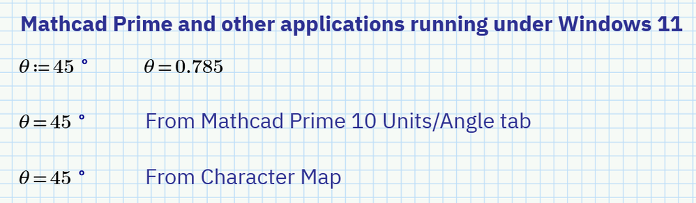

@Werner_E wrote:
The degree symbol ... Not sure how you created it. Depending on the language your keyboard is for you may have the degree symbol directly available. Otherwise you can also simply type "deg" (without the quotes) as the 'unit'.
I used the degree symbol from the Angle section of the Units dropdown in the Math tab on the ribbon.

You can also insert the degree symbol from Character Map - copy & paste.
I tried the (UK) Onscreen Keyboard (OSK) on my W11 Dell laptop, but Alt-0176 didn't do anything with the numeric keyboard enabled, and Fn-0176 entered the divide operator as soon as I pressed Fn-0.  OTOH, there were some strange interactions between the OSK and physical keyboard, so that may have played a part.
The degree symbol position in the unit placeholder doesn't look right - too much space.
From the SI Brochure, 9th Edition:
5.4.3 Formatting the value of a quantity
The numerical value always precedes the unit and a space is always used to separate the unit from the number. Thus the value of the quantity is the product of the number and the unit. The space between the number and the unit is regarded as a multiplication sign (just as a space between units implies multiplication). The only exceptions to this rule are for the unit symbols for degree, minute and second for plane angle, °, ′ and ″, respectively, for which no space is left between the numerical value and the unit symbol.
Stuart

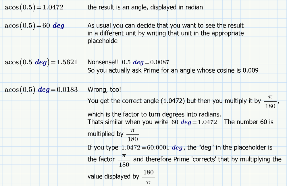

But this is still more annoying, no matter where I put the degree symbol, the calculation doesn't come out right. I can't even get one wrong answer, There has to many. But If I delete the degree symbol, then the answer is correct.
ttokoro
(To:cadtelsim)
(To:cadtelsim)
Not sure what you mean.
arccos, which is named acos in Mathcad, is a function with a unitless value (usually in the range from -1 to 1) as its argument and the RESULT of this function is an angle.
So of course its wrong to place the degree symbol after the function argument as you did in your first and third expression.
The second and fourth calculations wrong, too.
acos return an angle. If you add "deg" or "°" you multiply this angle by pi/180 and of course this leads to a wrong result.
You use "deg" only when you DEFINE or PROVIDE an angle in degree or when you DISPLAY and angle and want to see it in degree.
