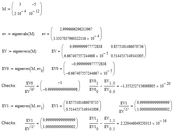

If you come across a specific matrix where the results of "eigenvectors" and "eigenvector" differ, I would be interested.
I tried a few matrices with small values but never came across any significant difference (apart from expected rounding errors).

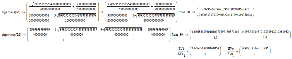

Here's an example
We can also compare the results of symbolic evaluation which give us a different, but equivalent set of eigenvectors

In the meantime I played around a bit and wrote with the help of Mathcads symbolics my own "EigenVals" and "EigenVecs" functions. For non-singular 2x2 matrices only 😉 They seem to work OK. Maybe they can be of help.
Just look at the end of your file.
