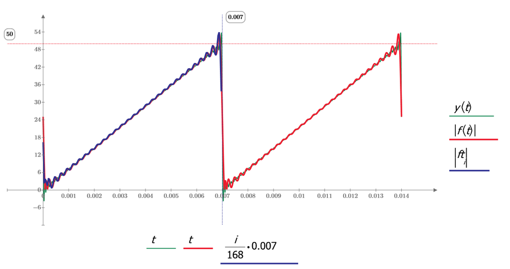

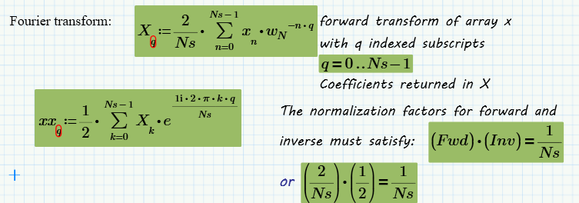

I haven't been able to do FFT's in Express as a function, but you can still do them vector to vector:
