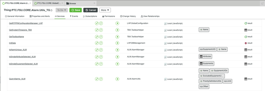

  • If you are not really looking to "subscript" to Alarms but just want to list Alarms in your custom mashup, you can simply use the "QueryAlarms_ALM" service on the PTC.FSU.CORE.Alarm.Utils_TG thing. Screenshot 2023-04-11 at 3.12.50 PM.png
