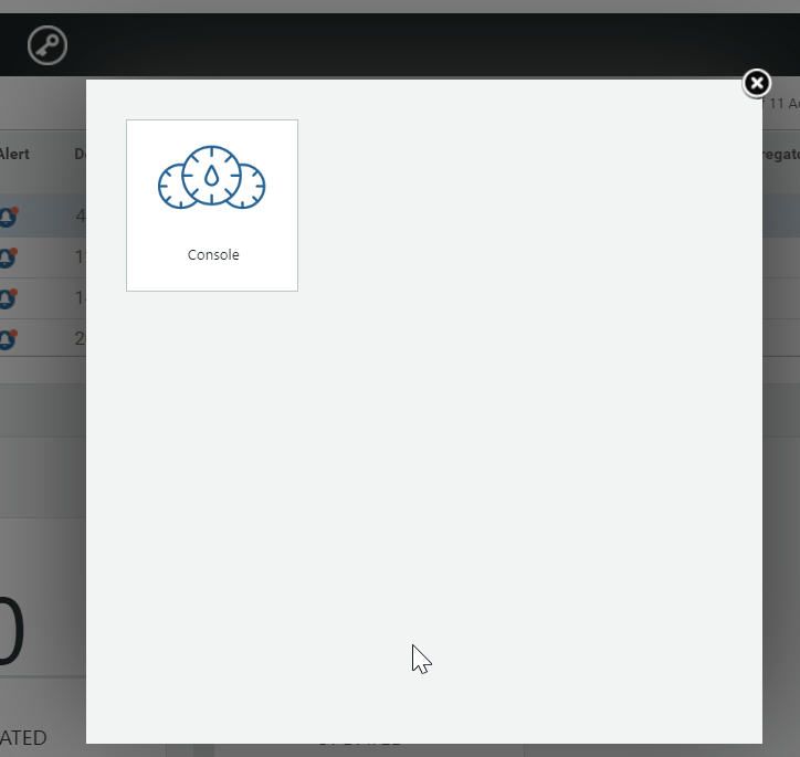

For some reason the mfg apps menu (aka Application Console) is not populating correctly.
The Controls Advisor, Asset Manager and other icons i usd to have have gone.

This issue might be due to following two reasons :
1) License expire/not proper, please check your license is upto date and have proper entitlements of Manufacturing apps
2) User Rights Issue, it might be due to proper rights not assigned to the login user. Try login using Administrator and
check if all tiles are visible if your license has proper entitlements.

This was related to a licensing issue.
PTC gave me a new license and the issue was fixed.
