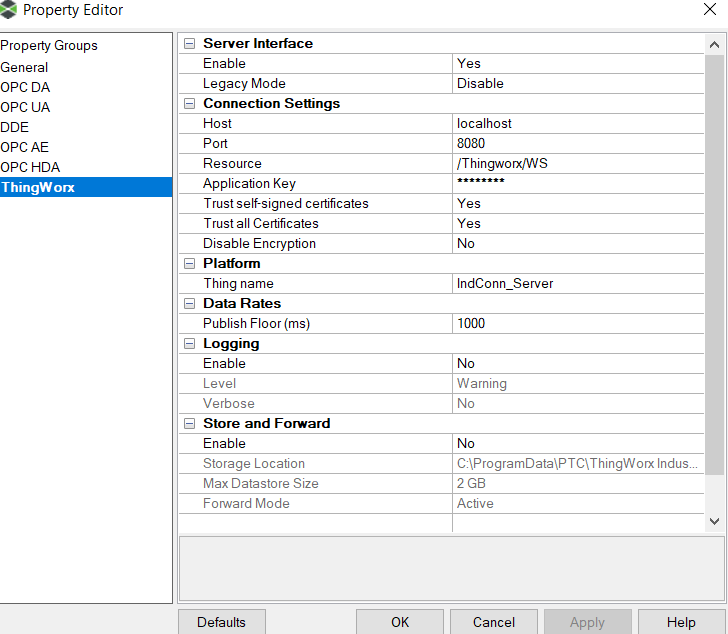

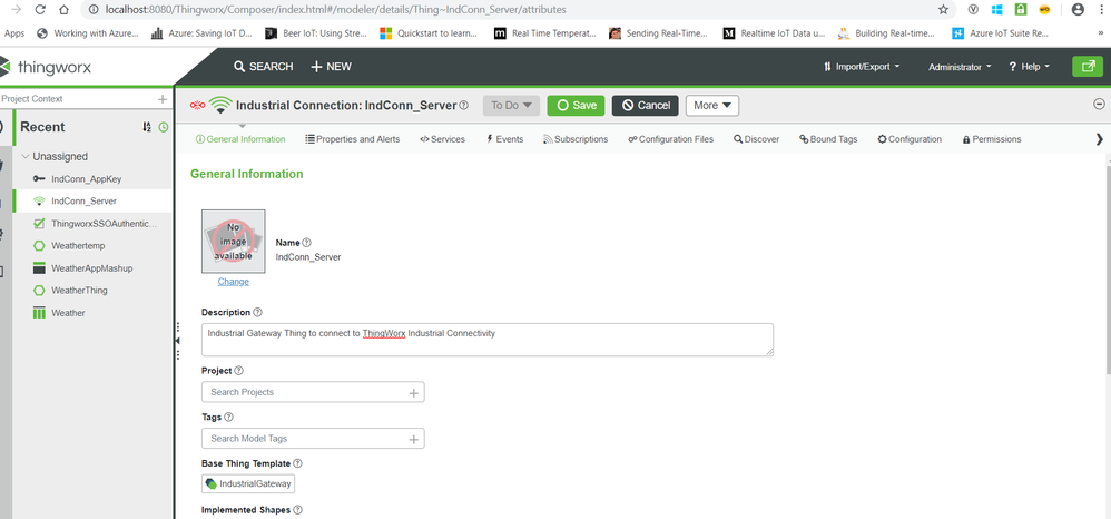

Hi Himanshu,
I just installed both Industrial connectivity(8.4.66) and Thingworx foundation trial(8.4). Getting the same error as discussed in this thread. I have attached both my Thingworx instance and property of IC.
Please help me out!!!!
Raj

Hi @RV_7 ,
Can you set Disable Encryption to yes and try to connect.
If this does not work, additionally change localhost to 127.0.0.1 in the host property.
Himanshu

Hi Himanshu,
It works. changing the host to '127.0.0.1' did the trick.
Raj
