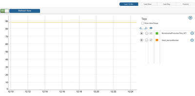

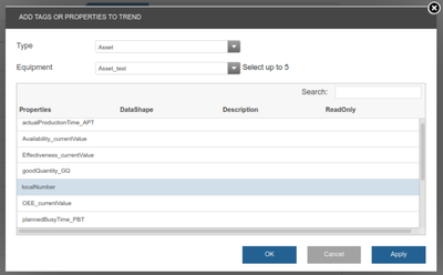

* Trending And Troubleshooting
What steps should I follow to:
  1. Display the Infotable properties in the “ADD TAGS OR PROPERTIES TO TREND” tag picker.nahuel_2-1608833258036.png
  2. Display the Infotable properties in the Chart.
