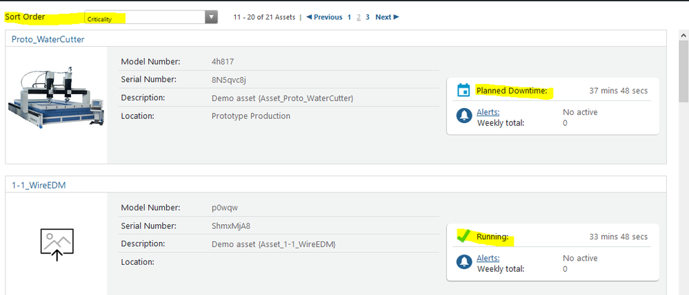

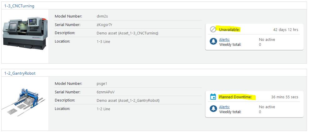

Let say value for criticalityOrder for status unavailable is 40, planned downtime= 30 and Running = 10 , then on Asset advisor page sort order by criticality fist is shows the assets which are unavailable then asset with planned downtime lastly assets which are running.
