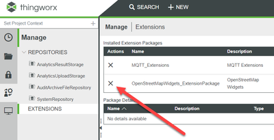

Alessio
(To:drichter)
Can you share a screenshot of the loaded extensions page?
Here I have a couple of unrelated extensions, but you will have yours and could delete them.
Maybe you can delete the extension that originally loaded those Data Shapes.
drichter
(To:Alessio)
The three datashapes have the creation date from the first attempt to import the extension. So I think the datashaped are from the extension and all three are in the metadata.xml of the extension.zip.
Alessio
(To:drichter)
...and do you have that extension listed in the loaded extensions page?
  1. Can you delete it?
  2. Or the problem is that you don't have the extension listed there, yet the Data Shapes have been created?
Are you in case 1 or 2?
drichter
(To:Alessio)
The extenstion could not be installed correctly, so it doesn't appears in the list of extensions. So I can not uninstall the extension and I can not delete the datashaped.
