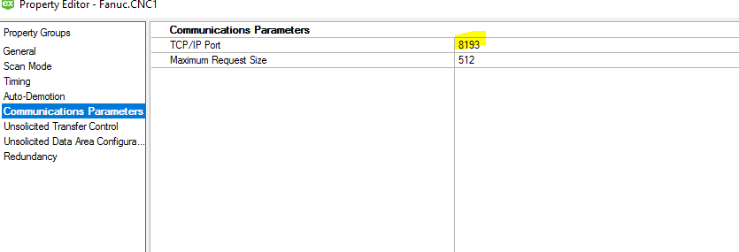

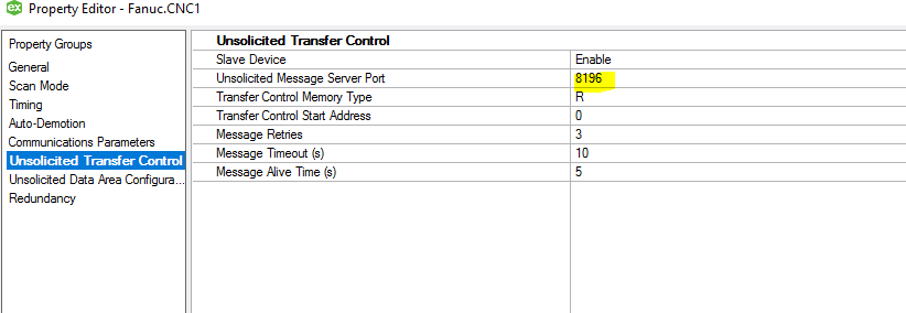

Hello communty
We have a Model Controller 0i-F
We are using Open Model in a device created with FOCAS library
We configured like that in Kepserver 6.5
1 Device CNC1 Model Open.PNG2 Device CNC1 Communication par.PNG3 Device CNC1 Uns T Control.PNG
Now, we choose Open Model but I can't get this tag from the CNC: cnc_rddynamic2_ActS and many others, but we need to star with one

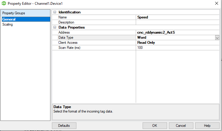

We configured the tag like that:
In Quick Client we see Good Quality but the value = 0
What o where we need to configurate to read de value?

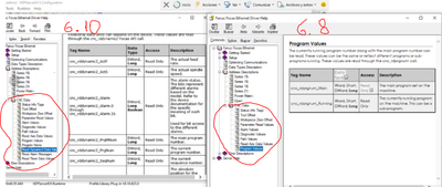

Hello Sharon,
Yes, the last week we get the solution, the problem was the Kepserver version.
There is very few information, it is an opportunity for improvement for Kepserver.
For us, to solve this problem had importan cost for the project, in money and in time
In the next picture you can view the difference the Focas function ables in the differents versions
it isn´t neccesary to use the program UMsgServ.exe
Thanks for you support

Thanks for the inquiry. It is odd that you are receiving good values on some of the tags and incorrect data on some tags. It is usually all or nothing with Fanuc tags.  The first recommendation is going to be to upgrade to the latest release of KEPServerEX v6.10. We have made several changes to the Fanuc driver since the v6.6 release that affect the variety of tags we can now read from.  If the upgrade does not resolve the issue, we will have to have you open up a support ticket so we can leverage our developer's input. Here is a link to our My Kepware portal where you can log a ticket if necessary:

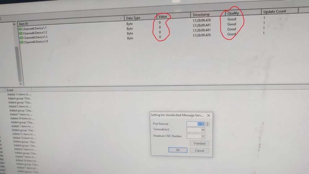

Thanks Chris,
In my PC I have Kepserver 6.5 but in develope server we have the Kepserver version is 6.9 and and others two PCs we are using version 6.10 with similar bad results.
When I say the tag has quality GOOD and value cero (0) I want to say like the picture shows.
We couldn´t get any values from CNC yet
Neither label returns a non-zero value (0)
Thanks for your help.
Matías

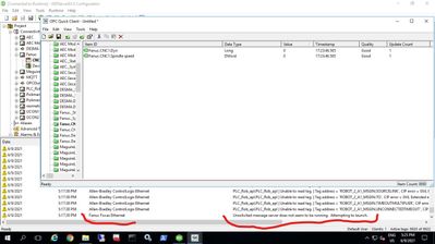

Hi Matías,
What does the event log say in KEPServerEX?  I'm guessing there are error messages and knowing what they are should help trouble shoot the issue.
Thanks!
-Ben
Hello, we checked in event log say in KEPServerEX and Kepserver has problem to lunch UMsgServ.
UMsgServ is running in the server......

Hello Sharon,
Matías
