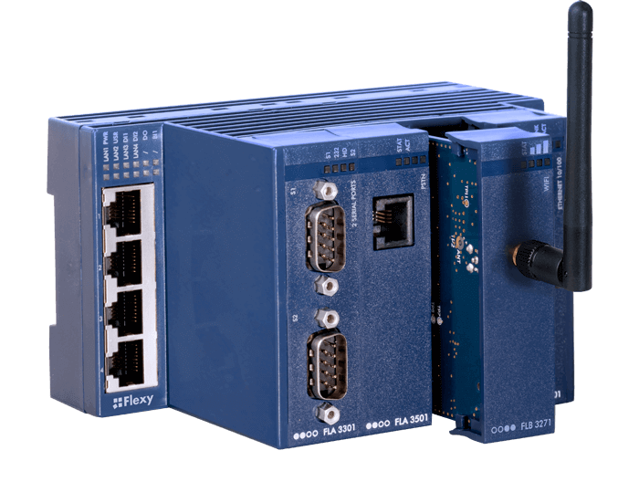

We have an eWON Flexy 201 device which connected PLC through ethernet. This device can read live data from PLC and with its Wifi/Ethernet modules, can push data to local/remote server using BASIC script language.
We can send live data to our remote Thingworx Platform using <host-ip-adress>/Thingworx/Things/<thing-name>/Properties/*
ONCHANGE "DB2x20", "@UpdateThingWorxProperty('xxxxxx-xxxxx-xxxx-xxxx-xxxxxxxxx','DB2x20')" FUNCTION UpdateThingWorxProperty($appKey$,$Tagname$) $url$ = "http://<host-ip-adress>/Thingworx/Things/<thing-name>/Properties/*" $method$ = "PUT" $Tagvalue = GETIO $Tagname$ $Tagvalue_String$ = STR$ $Tagvalue $DataToSend$ = '{"' + $Tagname$ + '":' + $Tagvalue_String$ + '}' $header$ = "Content-Type=application/json&Accept=application/json&appKey=" + $appKey$ REQUESTHTTPX $url$, $method$, $header$, $DataToSend$ PRINT "Value of " + $Tagname$ + " is sent to ThingWorx" ENDFN End
