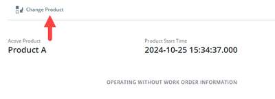

Marked "RunWithoutWorkOrderInformation" check box, it is running with DefaultJobOrder . But I'm not able to switch to other product (I'm able to see the 3 products assigned to this equipment).
I'm confused. Normally in the Operator Dashboard, it should change the top panel : it won't show the Joborder information and just show the product, and also the Start/Stop Joborder button should become Change Product. It should open a popup that allows you changing product. Which part of this is not working? Here is an example of what it should look like :
Please not that in order for the buttons in the Operator Dashboard to work correctly, you still need the properties (like RunningJobOrder and JobOrderRemoteTag) in Composer. It's just that the tag (like the one for JobOrderRemoteTag) will not be bound. This is because part of the manual logic will simulate sending a tag value in those properties. If the button throws an error, it's probably because part of the configuration is missing.
