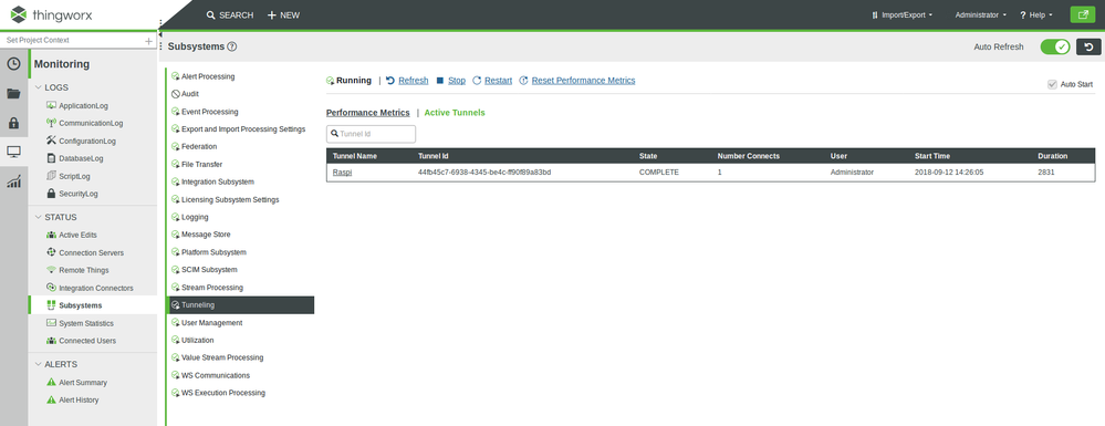

i am trying to use the remote access functionality in manufacturing app.
Web socket server and lua script run on a Raspberry Pi. RealVNC server is installed and running fine.
I am able to do file transfer and the tunneling seem to be working.
However nothing appeared when i clicked on Connect.
My wsems log just say that TUNNEL ENDED without any specific error:

[FORCE] 2018-09-12 14:16:15,383 SDK: TUNNEL CREATED. Entity: Asset_PiThing, tid: 81d592c3-03b4-4570-a9a8-994cfe935016, target: 127.0.0.1:5900
[ERROR] 2018-09-12 14:16:15,386 SDK: twStream_Delete: NULL Pointer passed in
[INFO ] 2018-09-12 14:16:15,506 SDK: twWs_Connect: Websocket connected!
[FORCE] 2018-09-12 14:16:15,506 SDK: TUNNEL STARTED. Entity: Asset_PiThing, tid: 81d592c3-03b4-4570-a9a8-994cfe935016, target: 127.0.0.1:5900
[FORCE] 2018-09-12 14:16:18,314 SDK: TUNNEL ENDED. Entity: Asset_PiThing, Peer: Administrator, tid: 81d592c3-03b4-4570-a9a8-994cfe935016, target: 127.0.0.1:5900
VNC's log say that wsem disconnect by itself.
The tunnel appear in the subsystem

I fixed the problem by installing tightvncserver and set tunnel address to 127.0.0.1:5901

Hi Bach,
Are you able to see the Asset_PiThing as connected  in composer ? If yes , then are you able to browse the remote properties of this remote thing ?
If both is working fine , then there is no issue with lua and ems . Then we need to check the vnc configuration .

everything is working, except for the VNC.
The VNC should be running. I am able to do remote using other VNC viewers.
Bach
(To:Bach)
