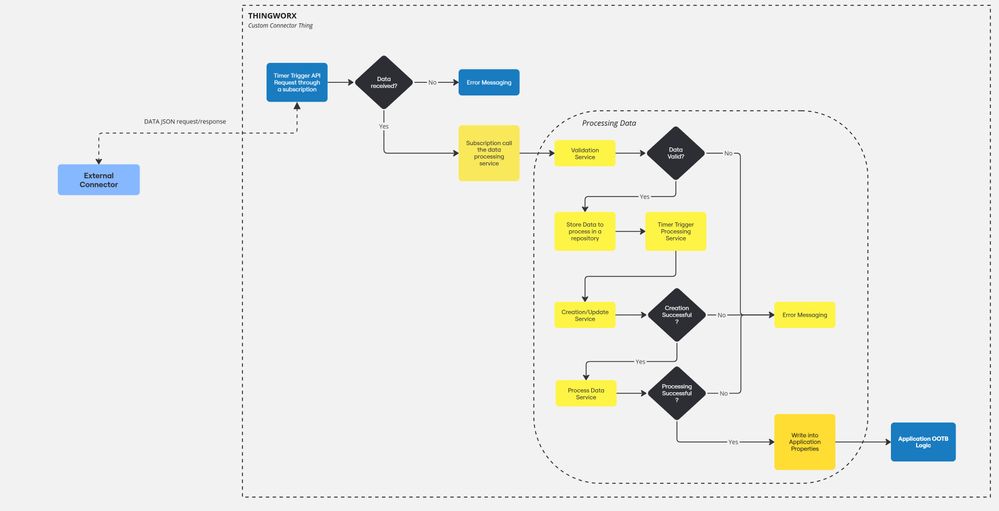

For data automation retrieval, there are 2 ways that can be used:
  1. External Source -> ThingWorx
The best practice is to send messages from external sources to ThingWorx. Then subscription can be used to trigger the data processing logic.
  1. ThingWorx <-> External Source
Another way is to trigger the external sources using ThingWorx timers to get the data. However, this is not recommended for performance and timing purpose.

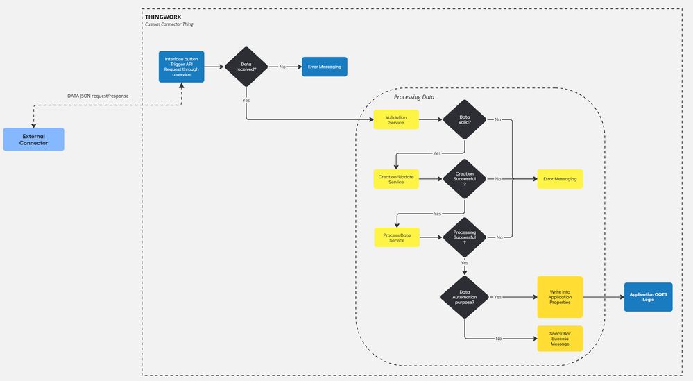

Interface Data Retrieval
On another end, it is possible to customize out-of-the-box ThingWorx interfaces and use buttons as triggers for data retrieval. In those cases, ThingWorx will ask for data to the external sources via GET request through the REST API.
  1. Create an External Connector Thing with the ODataConnector Thing Template
    1. Configure the thing properly according to the external source
    2. Create a JSON property within the external source can write
    3. Create a subscription that is triggered on JSON property data change
    4. Create processing data services that will be called within the previous subscription
    5. Write data in application properties so the OOTB logic can go on
    2. Create services or routes to request desired data from external sources
    3. Create processing data services that will call previous request data services/routes and then process the data
      1.      Write data in application properties so the OOTB logic can go on (data automation)
      2.      Create/Update actions (Data non application dependent)

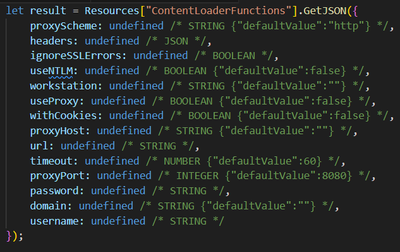

    4. API Call directly in a ThingWorx service
      1. Use ThingWorx Snippet for GET/POST request

Processing Data
  1. Data Validation
    • Make sure that the information received from the connector are properly formatted, valid and that they can be linked to existing data in the database (equipment, product, etc.).
  2. Data Creation/Update
    • If needed create/update record in the database
  3. Write into ThingWorx properties
    • Data received from the connector need to be written in the proper application property so the out-of-the-box subscriptions can detect a data change as they would have if the property would have been connected to a Kepware tag.
  4. Out-Of-The-Box Logic should do the rest.
Note that it is highly recommended to log error message to facilitate troubleshooting. Those messages should include the error section and the JSON message received.

HI @LB_9940670
