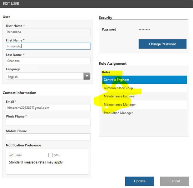

Hi @ChahatGupta ,
It seems that you have created user Chahat as Administrator from ThingWorx Composer.
For using manufacturing apps, you need to set the roles for user in Configuration and setup.
You can multi-select roles or you may choose all roles so that your user have proper permission for using all the tiles.
Capture
Regarding your concern of Administrator user not able to see few tiles, you can open a support case and appropriate engineer will help you in resolving the issue. This seems to related to licensing or other configuration issue.
