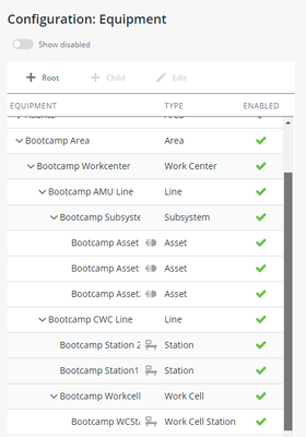

Here is an example from one of our test servers, that has all extensions : AMU, CWC and RTPPM. Notice the Assets (AMU) have their icons and Stations (CWC) have a different icon.
Please pay attention to the configuration guide, in particular to the equipment types, you will need to re-configure part of them. In this case in particular, you'll need to create the Station equipment type for CWC. Some other configurations may be required for CWC (that wasn't needed for AMU).

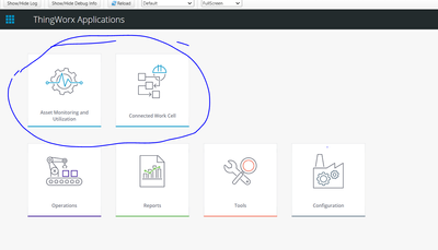

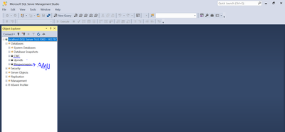

i tried to create separate database as of now on my local system as shown i below screenshot. it went well.
in fact it doesn't shown any difference on UI as well shown in Screenshot below.
I am just trying to check all here feasibility and possible solutions here before installing on actual servers as uninstalling is little chaos.
