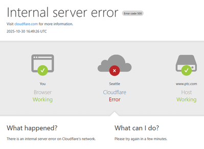

As of this week (10/28/25) I am unable to obtain an Activation Key for Express Modeling.  It was working fine the previous week.  Here is a step by step description of what happens:

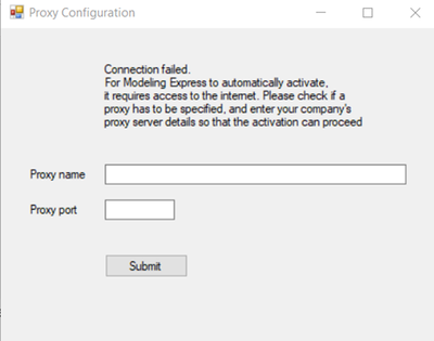

- I enter my email address and password, select ‘Activate’ to get this dialogue, also normal.
- In my case there is no proxy server, I am merely a PC on the internet.  My internet connection is fast and reliable.  I select the Submit button and obtain this dialogue:

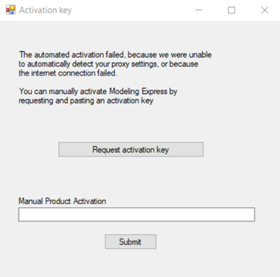

- At which point I select ‘Request activation key’.  Normally I would receive an activation key in seconds, paste it into the Manual Product Activation box and the program starts.  That has changed this week, now I get this:
- Any others having this problem?  Anyone know cause and possible workarounds?  Let me know please, I have numerous models of home projects I would like to access.

Hi Thomas,
You stumbled in a problem as few (hundred?) other people as well.
Please read the related topics. The problem is discussed in several topics.
In few words:
  • uninstall all your PE versions,
  • Download and install the PE90  (for download see modeling express in English )
  • for most of the people this have been the solution.
an incomplete list of related topics is listed ==>> here .

Hi Wolfgang
Yes, the installation of CE Direct Modeling Express 9.0 worked, I'm back up and running.  I need to rebuild my custom toolbars but that is typical for version changes.  Thanks for your help!

I have been getting THIS SAME CLOUDFLARE ERROR 500 when I try to use my CoCreate Modeling Personal Edition 3.0 which I have been USING FOR YEARS successfully. But when I tried on Oct. 25th, and the program tries to  request an access code from the PTC server (using:
https://www.ptc.com/appserver/securePeModeling/peManualLic.jsp?lang=en&u=bgmom&m=BETHSLAPTOP&w=6.1&v=30.00 ) it SEEMS that the delay created by the CLOUDFLARE "proxy" causes the PTC server to report "no internet connection" ... which is NOT the case!  Research re. the Cloudflare Error 500 says that IT IS NOT AN ERROR WITH CLOUDFLARE, BUT with the host server ... PTC.COM.  Cloudflare is sort of an "intermediary reverse proxy server"  to prevent BOT attacks and DNS attacks on the PTC server, but it APPEARS that PTC implemented its use WITHOUT understanding that the induced delay "crashes the program" (failure to supply access codes)

There is a temporary solution that I found that does work.  If you install the German version of Direct Modeling Express 9.0 and run it, it will allow you to get your temporary key for 72 hours.  Then exit the German version and then start your Direct Modeling Express 8.0 and the 72 hour key is valid.  Strange way to get it to work but it does.  I have an open ticket with PTC but they are not willing to even look at it.

  I tried 9.0 and got the issue where the PTC activation page came up without anything more.  That's when I tried the German version and it worked as I stated above.  I'll see what happens in 4 days when the activation key expires.
