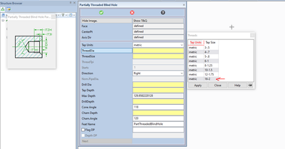

Hello i want to add new sizes for threaded holes. For example i only have until M16x2 and i want to to do a M24 hole.
See picture below.

You should learn Machining customization from Modeling help pages. There are some useful examples of how to do that. Then you should add some data into MachiningAdvisor\ma_customize file.
I dont have any of those files.
The modeling help page also refer files and tables that i dont have also.
Please look at the attached link.  This question was posted awhile ago to the CoCreate Users Website (the former name of CED).  In the reply,
I included the files you need.
https://www.cocreateusers.org/forum/showthread.php?t=8222&highlight=machining+module
