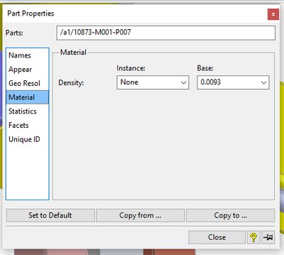

Material name beside the density
There is no option to emphisize the name of the material. It is insufficient knowledge to enter only the density of material.

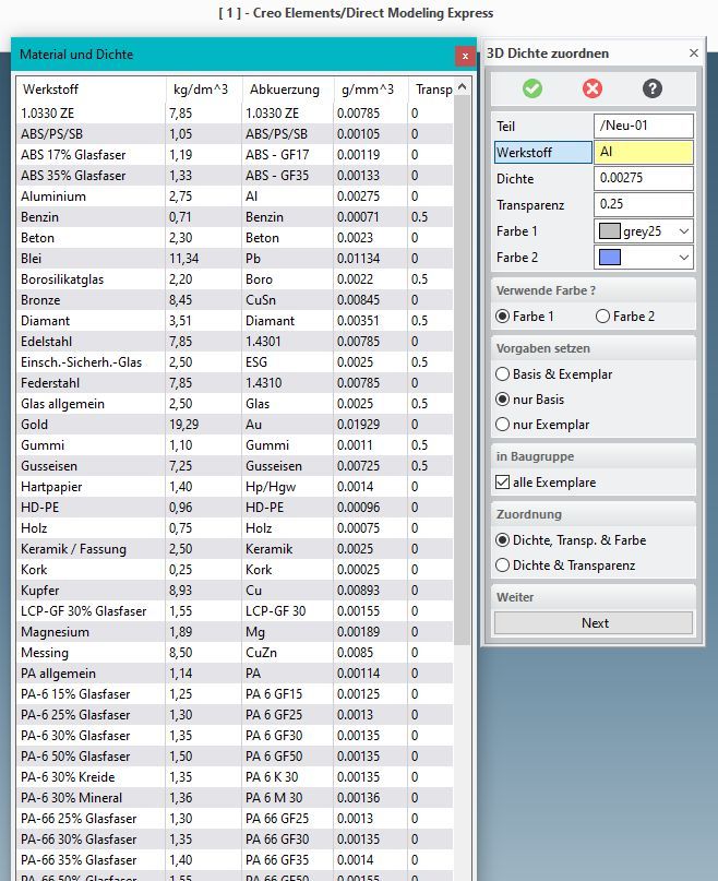

You are true, this proposal for improvement is already decades old.

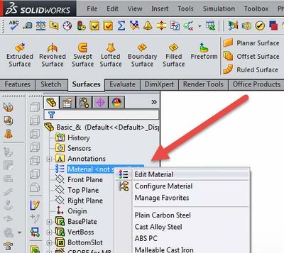

Usually you should have a table for selection of materials and also be able to design it by yourself.
Could look like this (sorry for german language):
SolidDesigner-20.5 + PE8 + PhoenixPDM + Solidworks + Blender
