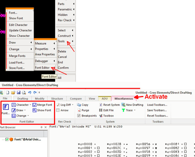

1. in Creo Elements Direct Drafting there is a macro collection with which you can change existing fonts or create your own new ones. It dates from the time when ME10 could not load Windows fonts.
But this is more than work intensive and has other disadvantages.
-You would have to change or create every single letter and this for every font you need.
-If you give your drawing to someone else, the new font is not known to his computer, unless you save the font with the drawing and that makes the files bigger.
-Export to dwg for example = absolutely no chance.

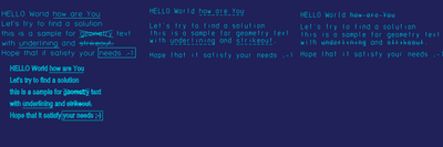

2.  Have written the text with a 2nd line and tried there to accommodate the lines as text. To do this I chose the letter key combination ALT+0175 and gave the shape with line spacing and editText. (Look in the attached .mi file for deails)
But this works only for single lines and the export for example to dwg = catastrophic.
3.  i use this solution in Drafting for a long time and thought about how this could be realized in Annotation.
So create a sketch. In the sketch the text in the desired standard font. Then draw the desired lines in the sketch.
This sketch can be moved as a unit, is displayed in annotation on every computer in the same way and the export for example to dwg = well, +/- reasonable.
In Drafting you make a part instead of the sketch.
Certainly not as luxerious as in Word, but a feasible workaround.
AND you can also add many other things, e.g. cross a word or leave space in a line and insert there a word in a different font, etc.
Well, have fun trying it out and have a look at the attachment.

Your answer is very interesting. I would add something to solution No 2.
I tried for multi-line texts and that works. I do not understand why you said that it does not work.
On Annotation or Drafting, use a fixed space font, example hp_i3098_c with a ratio of 0.8 to be more similar to the variable space font hp_i3098_v.
It is easier to place the character ALT+0175, especially with the command EDIT_TEXTKotomEng_0-1669624478864.png orKotomEng_1-1669624686980.png for Drafting.

With your suggestions it looks better now, even if the line looks like a tittle when underlined.
Strikethrough looks better if you insert a blank line between each line. But it also remains a little bit unfamiliar.

Another question. The command
I cannot find in Modeling 20.4x + Express 8. Can you show where?

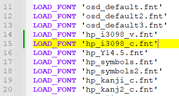

The "hp_i3098_c" is available in Modeling/Modeling Express but not declared. Just add the line
in the file C:\Program Files\PTC\Creo Elements\Direct Modeling Express 8.0\Annotation\win\startup.m
EDIT_TEXT KotomEng_1-1669651645653.png KotomEng_2-1669651645611.png are in Drafting. Same command as in Annotation (fixed space editor).
In Drafting, there is another command for editing text, WUI_EDIT_TEXT EDITOR, which is a variable space editor. Therefore not well suited for fixed space fonts.
