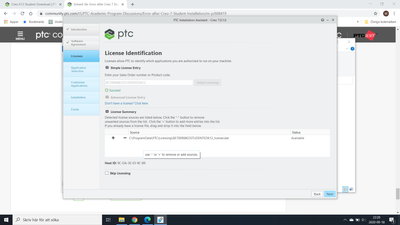

Hi Alex,
I have tried to no avail with the License Identification Process. Attached is a photo of what that screen looks like. It appears that the license has already gone through. I ran as administrator and did the whole setup.exe process again. Any suggestions?
Thanks in advance,
Grant

The license is already there and available. It appears as available in the screenshot.
You have the license, so stop trying to put the product code in. You should simply click next and finish the installation.
The only reason for Creo not to run after the installation is complete is if there are not sufficient permissions on the PTC folder, to allow the setup to populate the files from there with the license information, OR if there are multiple licenses (but if there were, they would be shown under license summary).
So my advise is to try to set full permissions on the PTC folder from Program Files and run setup again, just clicking next, no product code needed.

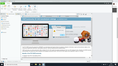

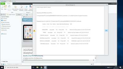

Tellgren
(To:Alex_Cazacu)

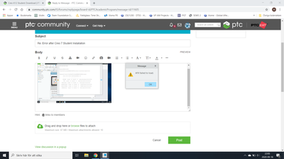

Thank you for quick reply. I decided to change to a newer laptop, to get some better performance. Unfortunately the error still remains though:
second one:
third one:
Then shutting down.
The license you have is for Creo 6.0. Please run the installer (setup.exe) and choose reconfigure existing software.
In the licensing window, please click the minus in front of the license with BE600... or any other shown under License Summary and insert in the simple licensing the code:
BE700908EDSTUDENTEDK12
Alex

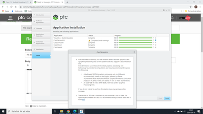

Crap, I saw the text. Ok, new try:
Seem to be ok. I had to remove 2 B600......
Installation worked, but with performance warnings as I see it:
I removed B600... from ProgramData so only B700.... is available. New start:
It still looks for B6000?
Tellgren
(To:Tellgren)
Sorry, didn't run reconfigure. Doing it now......
Update: It works! Thank you! 🙂

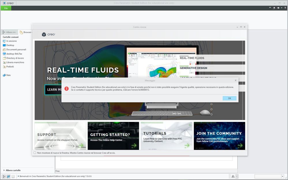

Lorenzo
(To:Alex_Cazacu)
I have similar issues for Creo 7.0.0.0 installation. Maybe there is some wrong license because i first got a license for 7.0.1.0 (but I'm not sure).
Hese is what I see before everything shuts down:
Lorenzo Sparacio
I hope @Alex_Cazacu can comment the question.
